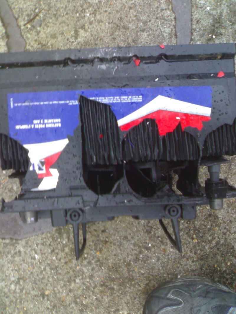

[url=http://imageshack.us][img]http://img186.imageshack.us/img186/8806/ef15sl9.jpg[/img][/url]
