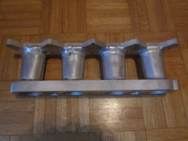

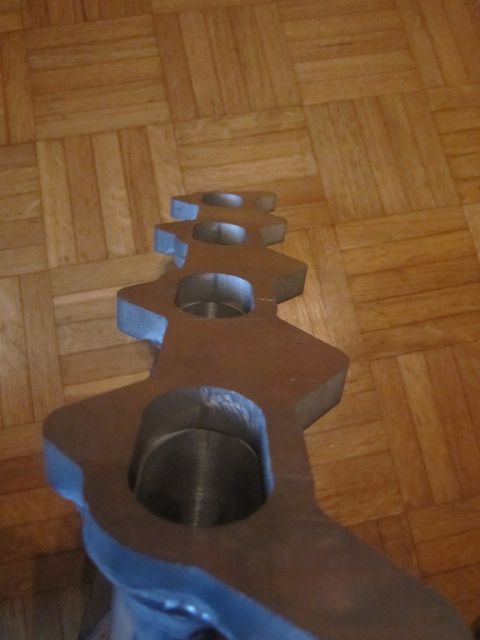

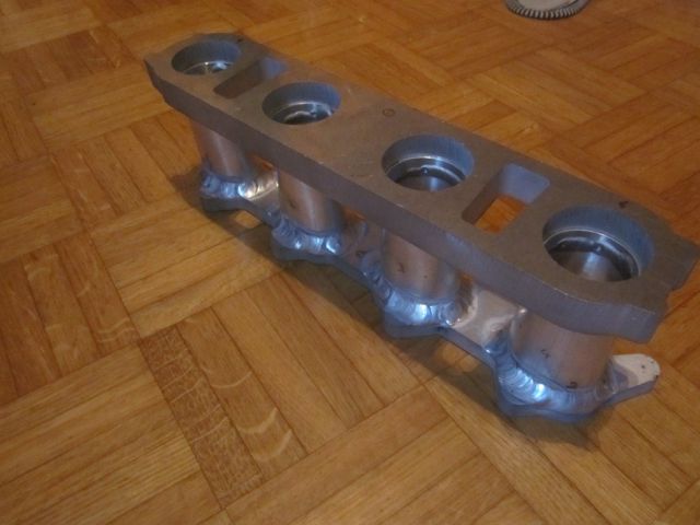

I made some progress on my inlet manifold. It's all weleded together. Now I have to make some fine corrections with the dremel and then it's off to the machine shop again to CNC some slots for ITBs and o-rings. Then I have to take to to another machine shop to skim the faces, because due to welding metal warps a little bit. Then drill some holes and it's almost done! :D
After all that, I will anodise it. I haven't yet decided in what colour. :)
Manifold currently weighs 1390g. My objective is to trim it down to 1250g.
