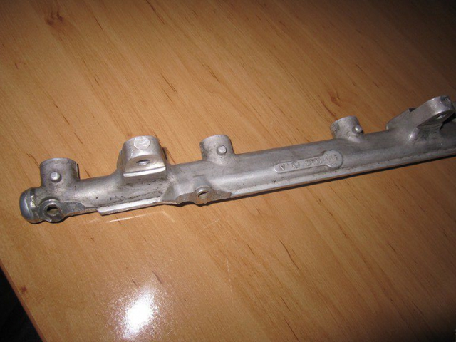

I also began modifying the fuel rail so I can fit Goodridge fittings
