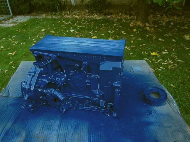

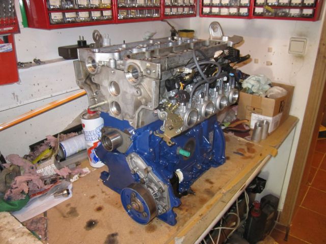

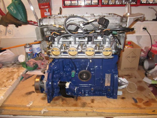

I've cleaned all engine parts, so everything is as close as possible to new items. Every little detail was measured with micrometer, so components will be assembled in a way that combined measurment will cancel out as much imperfections as possible.
Every component was weighted
Cleaned thoroughly
... down to every single bolt
Head and carriers will be additionally cleaned with ultrasound

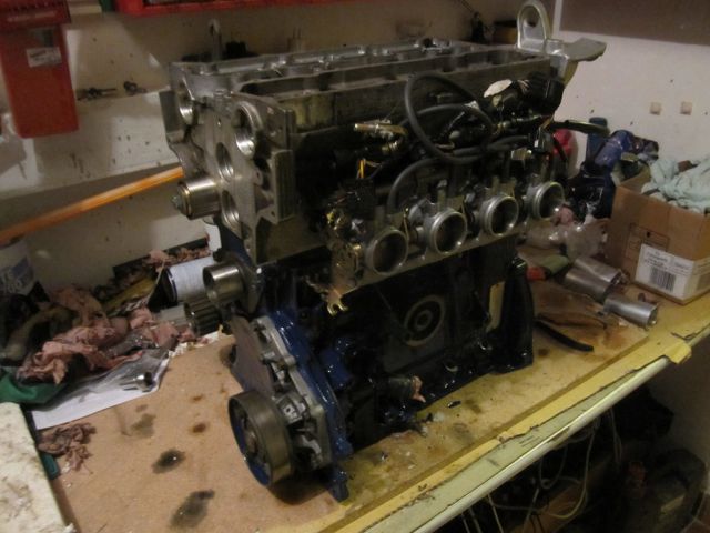

I also bought an engine stand, so assembly will be a bit easier

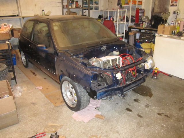

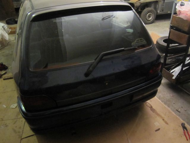

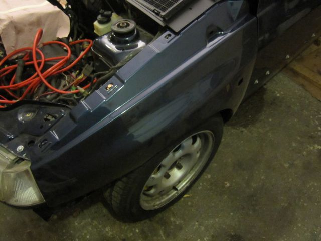

Interior is mostly fitted, I'm just waiting for some clips to arrive and then I can fit the door panels.

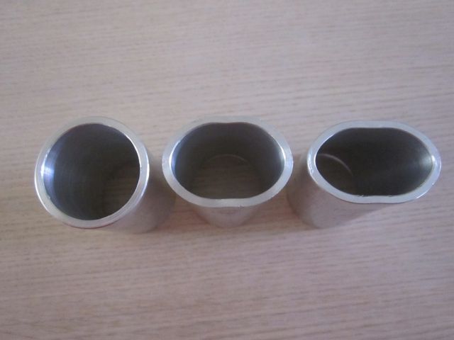

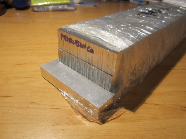

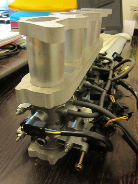

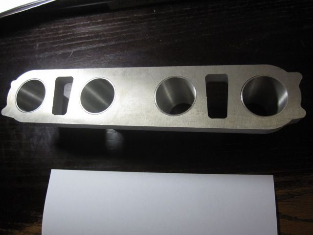

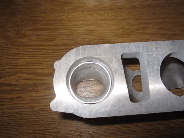

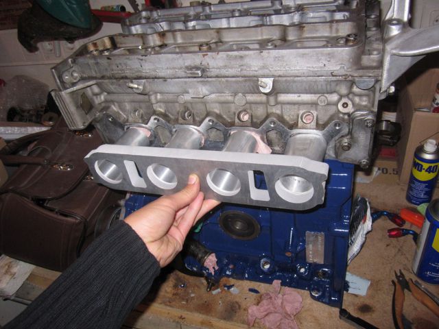

My custom tapered inlet runner pipes were also made. I ordered 8, because 4 will be used for experiments and creation of a jig where 4 perfect runners will be made.
Tapers from 42mm (ITB size) to 38mm (megane head port circumference)

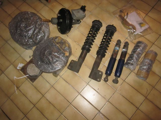

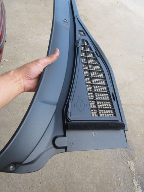

Lots of brand new original parts for my Willy

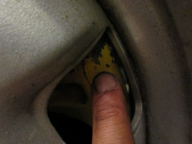

A very expensive sticker!
Door cards fitted. Just a few clips and bolts left.
